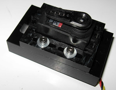

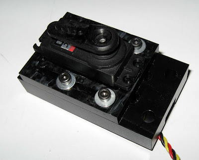

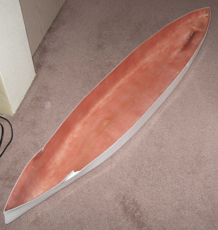

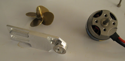

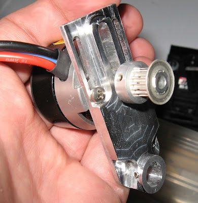

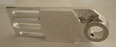

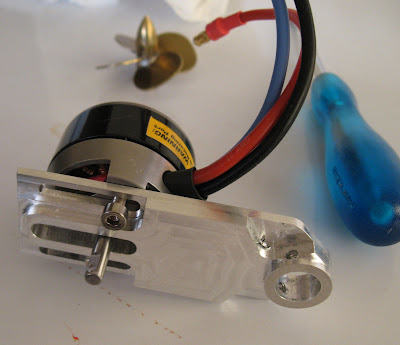

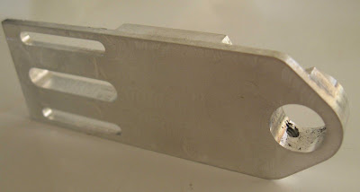

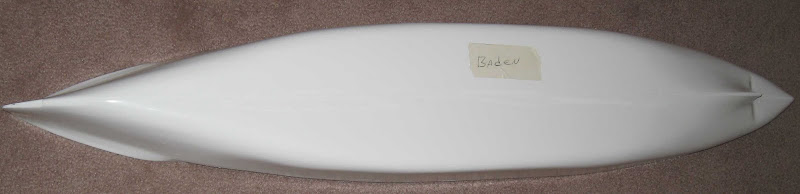

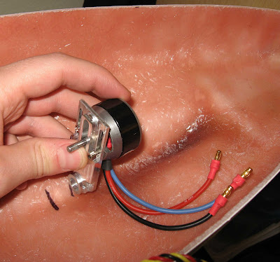

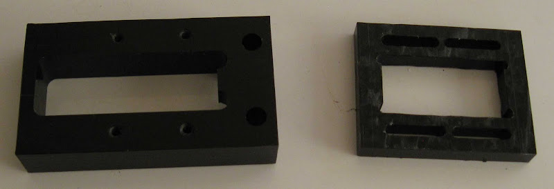

    Well, now it is time to kick off the Baden's build. Today was productive, I made the rudder servo mount and rudder post alignment critter (the mount does dual duty) and I made the belt box. anyways, I can't speak highly enough of the quality of Stephen's hulls (Strike Models). A nice thick (but not too thick) fiberglass layup.
    First up are hull pictures, followed by pictures of the servo mount, and finally the pictures of the belt drive mount.
    anyways, pictures!
    [​IMG] [​IMG].

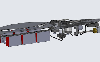

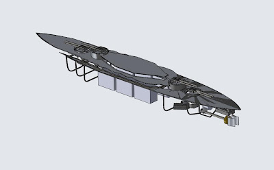

    and here are a few images of how I am planning on laying her out at this point in time.
  6. JustinScott
    JustinScott Well-Known Member
    2,232
    Only guy I know who solidworks-designs his ship before he builds it.

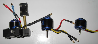

    Alright Folks , a question in need of opinions:
    For the new one unit pump I am making based on the design of my half unit pump, I have two different options for motors. Unfortunatly, due to the utter stupidity of the folks that build both classes of motors, the mounting patterns for the motors and the shaft sizes are different. That means that the two motors are not interchangable. If it was only the shaft, I could readily fabricate a suitable replacement that matched the sizes, but with both mount and shaft different, I really have to choose one to design and build the pump around, and hence the pump voltage of the ship... both motors should happily run in the design range of the pump impeller of ~13000rpm if run on the right voltage source. Both pumps have same material requirement.
    I would like to hear opinions on either direction, as I can not see a truly overreaching reason to pick one over the other. I currently lean towards the slower/smaller motor, but for no reason of any substance. Even the extra tooling needed isn't a big deal as it is getting time to replace a bunch of my cutting tools anyways.
    the picture shows the 1/2 unit pump on the left, the heli motor in the middle, and the plane motor to the right. Basically, I have to
    The specs and my notes are as follows:
    Option A: (call it the 6V ship power option, middle motor in the picture)
    3500RPM/volt nominal (free RPM of ~21000)
    Idle current: 1.6A
    Max Continuous Current 19A
    Shaft size: 3mm, , 17mm spaced M3 mounting holes, 16mm spaced M2.5 holes
    Bonuses: 6V primary power for entire ship, 12V suppliment still required for solenoids. More powerful, higher speed allows overcoming losses by cranking up speed. Could use onboard ESC's bec to power servos/reciever/ etc.
    Negatives: Need additional tooling I don't have to fabricate impeller for 3mm shaft (probably 30$ worth of cutting tools, give or take). Onboard esc's bec may (probably is) insufficient.
    Option B: (call it the 12V pump, 6V propulsion, right motor in the picture)
    1360RPM/volt nominal (free RPM of ~16000)
    Idle current: 1.0A
    Max Continuous Current 12A
    Shaft size: 1/8 in, , 97mm spaced M3 mounting holes, 16mm spaced M3 mounting holes
    Bonuses: No tertiary 12V supply needed for cannons. Tertiary 4.8V supply almost certainly needed for servo's & RX. Motor top end closer to design point of pump, slower top end speed, not as much overage available on design point of pump. I have basically all the tooling needed to fabricate this pump now.
    Negatives: Less overage available as far as speed is concerned. No BEC as a viable option, as the bec's are typically linear voltage converters, 12V to 5V tends to get awfully hot if not carefully cooled and can let out the magic smoke.
  11. rarena
    I like the smaller slower less voltage motor. In a Baden, it would be nice to be able to keep it all 6 volts. There isn't a lot of room for extra power systems and more volts do equal more power drain (usually) and heat. A pump would be running a lot.

    Unfortunately, those two are mutually exclusive. the smaller, lower powered motor needs 12V to get to the required RPM... I do like the idea of all 6V with a small boost regulator or battery to run 12V solenoids.... I am still just not sure the best way to go.

    I have a baden and in it is the BC pump housing with a Traxxas Stinger motor (specs online). I was running fine at the last battle with full pump stream and what turned out to be 37 belows without for 15-20 minutes with no sign of settling.
    In my ship the recommended strategy is that my pump needs to keep me afloat long enough to empty my magazines then sink or go on '5'. If I am on the water after very long after that I am racking up fast gun damage points that can easily provide more points than a sink.
    In this case I want the best motor I can get to push the water out fast as I dont have much hull volume and need to keep what I do have - empty. It already sits so low in the water I call it a surfboard.
    I guess some of it might be affected by how heavy you build the ship. My ship runs right at max weight, largely due to the way the ship was constructed initially (its used) and I dont want to completely dissamble it (subdecks, shafts, etc.).

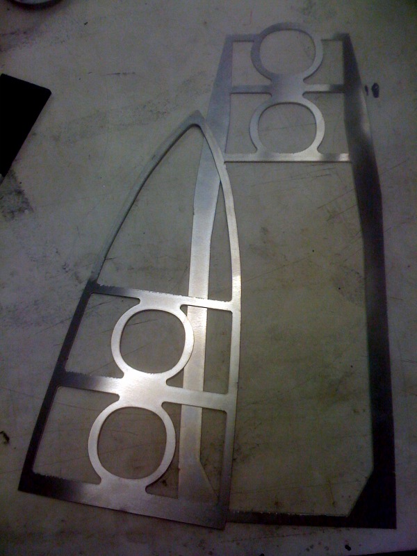

    A friend of mine made these on his plasma table as a test. the table is new and still needs a little tweaking so the holes are circular, but I can fix that on the mill rather readily, I suspect.
  18. NickMyers
    4,410
    Those look real nice. How do they compare in weight to wooden fabrications?

    they weigh about the same as the same footprint cut from 1/4" thick plywood, not including the waterproofing sealant weight.
