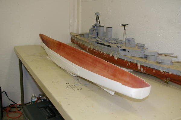

    My new project just arrived yesterday.
    RE: USS Alaska (Treaty/fast-gun)
    RE: USS Alaska (Treaty/fast-gun) Oh WOW, it looks great. How many units in Treaty? Or is it Big Gun?
    She will start out as a Treaty boat.
    Even though she only gets 4.5 units, she is very fast as far as capitalships go. 33 knots. So 27 seconds over the 100' speed course.
    So she will have a speed advantage over pretty much all axis capitalships, and a large number of the axis cruisers.
    I haven't decided yet just how I will arm her, but I have never been a big fan of stern guns, so I would anticipate using the ship to
    run down axis cruisers, and/or finish off any axis capitalships that are already pumping.
    She has the ability to have twin firing sidemounts (in the same turret), as she is over 800' long.
    I think she will not only be a nice addition to the allied fleet, but also be a good running mate for an Iowa class battleship.

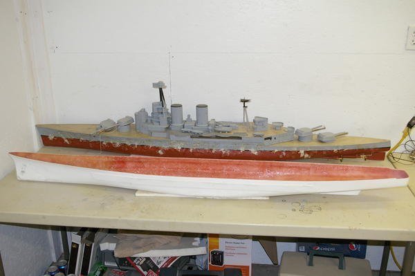

    RE: USS Alaska (Treaty/fast-gun) A hearty well done to the Strikemodels team for another great fiberglass hull.
    All of the dimentions are correct. Hull has a nice uniform thickness. The upper edges are nice and even.
    My favorite part of the hull is the armor belt.
    I have read that the actual ships had the armor belt welded right on top of the hull plating, and the belt on the Alaska hull
    matches my plan set, and has a step at both the upper, and lower edges.
    So for the formats that allow two stingers on the hulls that require them, I can keep the armor belt as-is, and keep the ultra-scale
    appearance. (Which I like).
    But for the formats that only allow one stringer, it would be a simple task to feather in the lower edge of the belt, and leave the upper
    edge as-is, and the hull will still look great on the water.
    So thanks again to Stephen, and Keri, for getting another fiberglass hull on the market.
    Especially one that might be loved by many, but prefered by the few, when it comes to combatants.
    Thanks also to those that started this project, and those that put forth the effort to make sure that it would be finished eventually.

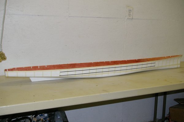

    RE: USS Alaska (Treaty/fast-gun) Nice to see an update to this thread; is that the quarter-inch masking tape that Strike Models sells with their kits now? Awesome! Are those black lines for stringers?
  20. froggyfrenchman
    RE: USS Alaska (Treaty/fast-gun) That is in fact the 1/4". and 3/8" ,asking tape from Strikemodels. It is great stuff.
    The black tape is marking the upper, and lower edges of the armor belt.
    I have been wanting to get started on this project, but have been too busy.
    I would anticipate that my progress will be rather slow on this ship. But I am excited about getting started
    on her, so that will have to do.
