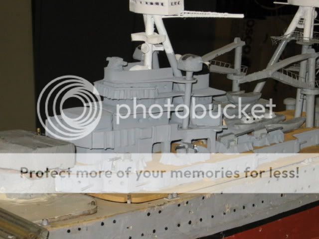

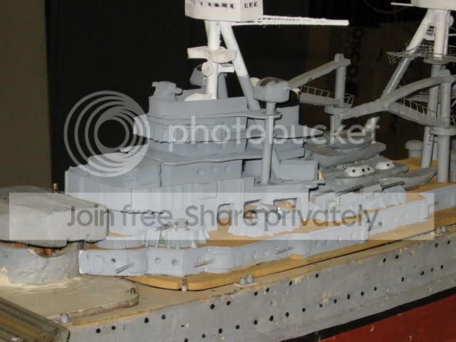

    As you can see, there's still some work to be done with the bow, but the biggest issue was dealt with, at least for the time being. After I finished with this repair job, I started work on scratchbuilding the superstructure levels. The reason for scratchbuilding is so I can have a Sunday-best superstructure with all sorts of pretty detailing, and then a superstructure for getting shot up. Who knows, I might just use the Sunday-best SS all the time, just for kicks.
    Amidship from forward, elevated to show the first two cut levels of the superstructure, with A and B turrets in their places:
    Similar view, this time without A and B turrets and with another deck set in place:

    It might not matter with ship, since she's so heavy, but that method of SS build for most ship will put too much weight up too high and cause listing issues and a ship that rocks a lot. You could build this way then drill large holes in the middle sections that are covered by other sections of SS.
    Make sure and seal it all really well with a good marine epoxy that UV resistant.
    Again Iowa's get so much weight it might not matter.

    I hear you loud and clear on that, Bob. The base of the SS already had a 2x17 segment sawn out of its middle, and I'll probably take at least a little out of each successive level with a little drill press work and the dremel, seal the wood, prime it, and paint it.
    Bob beat me to it! Saw out the centers, I've done 1/4" thick SS walls with a thinner 'roof' on top.
    Even if it's going to be pretty, don't put ballast above the waterline :)
    But it definately is nice work, very good looking even in it's early stages of completion :)
