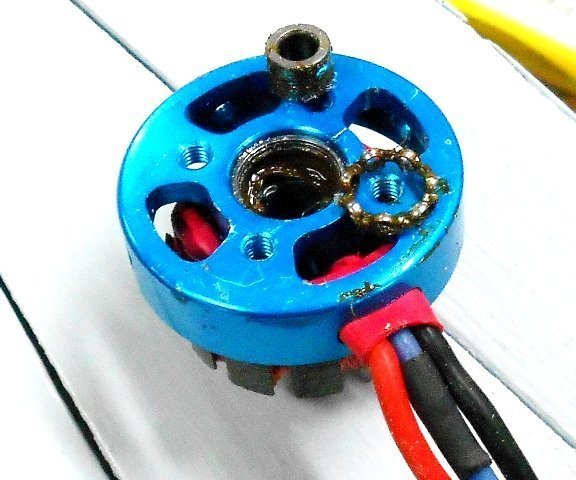

    In case you are interested in what water will do to the bearings of your brushless motor, here's an example:

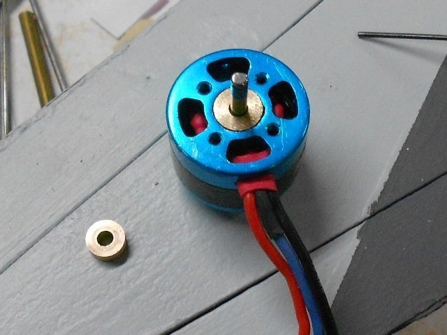

    The grease in the bearing looked more like rusty sludge than a lubricant. The bearing was also rusted in place, so it was destroyed when I tried to remove it. I had to grind out the outer race with a diamond tool. This particular motor was used on a pump and this was the bottom bearing. The top bearing was also rough, but at least I was able to get it out easily. I replaced both ball bearings with sleeve bearings and will test it in battle today. In addition, I added a coat of lacquer to the stator, since I noticed that the iron plates tend to rust.

    I used to use aeroplate oil to dip the whole motor in to protect it (periodic dippin). I am out now and can not find more. One other option I have tried is the teflon bike chain lubes on the non-bearing components of brushless motors. worst case stainless bearings are available.

    at 7$ you can get stainless steel bearings. one other thing I worry about on the pump in particular is having bearings operating at high speed filled with water under load can cause balls to skip and shorten the bearing life.

    that type of failure is typically rather rapidly catastrophic

    The plain bearings worked fine. In fact, I had to bring the ship close to shore to check if my pump was running, as opposed to the last battle where I could hear it from across the pond.
    My pump is probably only turning between 2000-3000 rpm, so I'm not too worried about life on the bearings.
