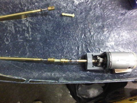

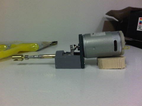

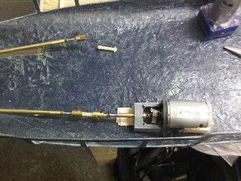

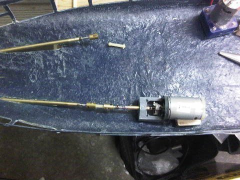

    Here of some pics of the gears and motors.

    Question: why did you add the dogbones in the fashion you did? That's different than the usual method I see, so I'm curious why you did it that way.
  14. bb26
    The dogbones counteract the slight upward angle on the shafts.

    I wondered on the dog bones with what appears to be the BC gear boxes. I just sanded the bottom of the gear boxes to the level that I needed for my Marlborough. That way I didn't need the universals at all. The shaft lines up with the motor just fine.

    Even if I sanded the bottom the gears, the entire housing would have to be raised. on one shaft I just have it shimmed with 3 pieces of 1/32 balsa so that it is almost inline. The prop shafts angle up so that is why I am using the dogbones.
