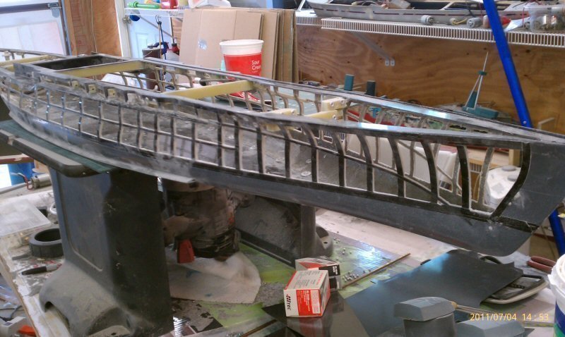

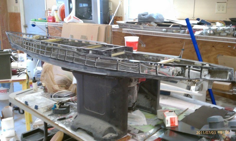

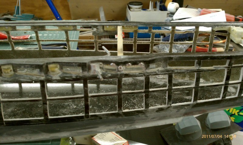

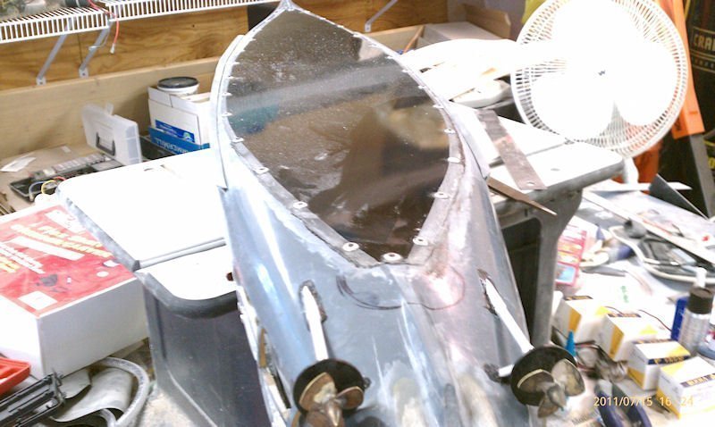

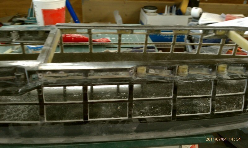

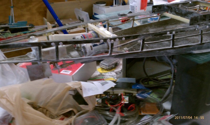

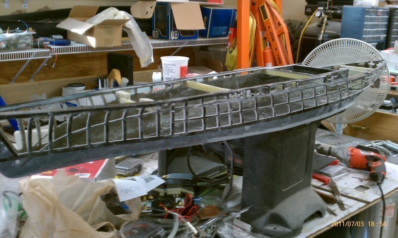

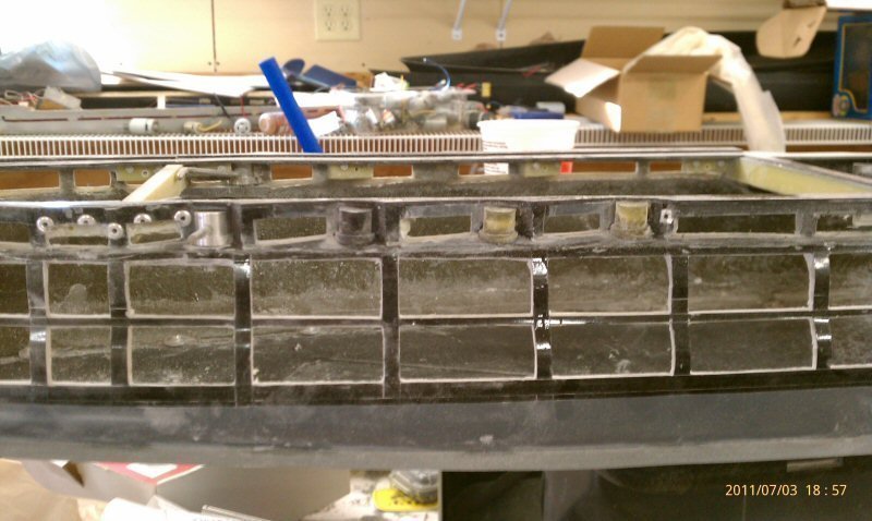

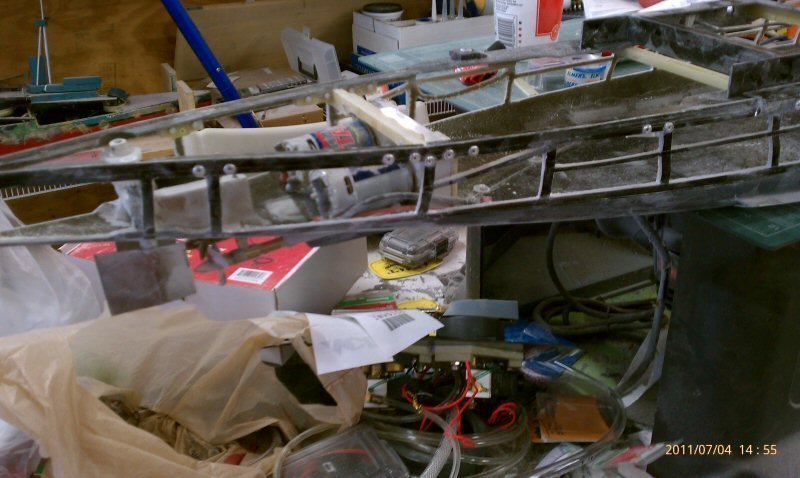

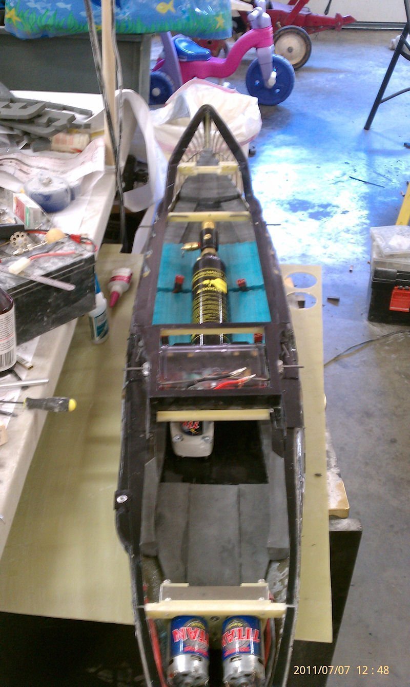

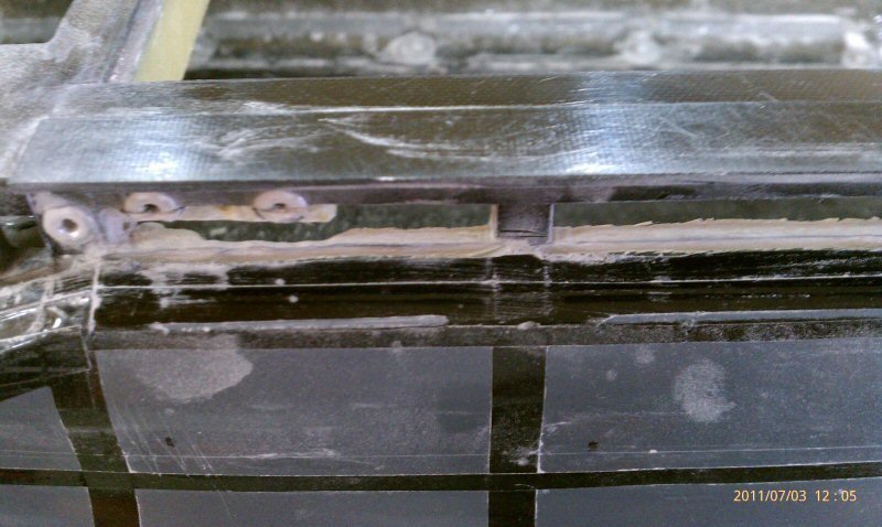

    I have neglected to post the rest of my construction pictures I took back in July. I got in a hurry and didn't take enough pictures to properly document everything.:crying:
    This shows the casemate cutouts prior to some cleanup with a hand file The riveted blocks that hold the subdeck on were cut back farther into the hull to allow enough room for any bbs to pass cleanly through the balsa. Note the slot cut in the top of the bulge, right where the gunwale would be. The balsa covering the casemate area fits down into this slot, eliminating the failure prone butt joint commonly used in this area.
    One side mostly done.
    More views of the casemate area
    The other side cut out.
    Water channeling is just plain grey flooring foam. This didn't work out so well, the cheapo harbor freight brand of flooring foam I tried absorbed some water over time. It lost about 1/4" of freeboard during the week of Nats due to absorbed water.
    Finishing up the bottom of the hull. Servo wheel drag disks.

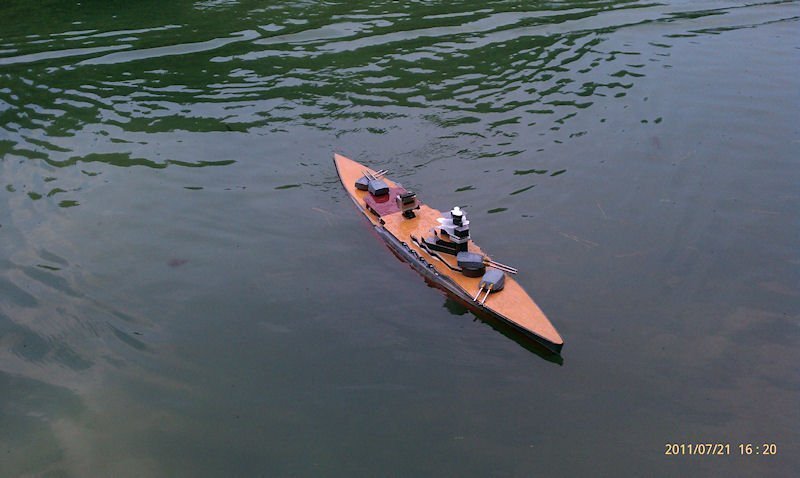

    Float test. Turns and accelerates nice. Needs a little more superstructure. :whistling:
