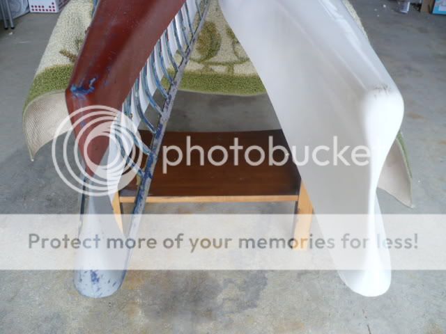

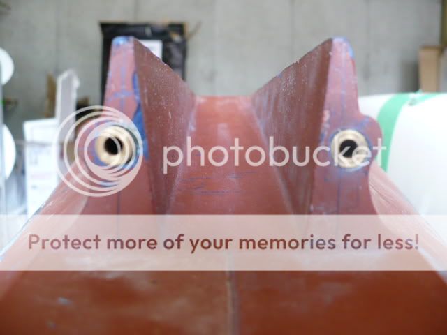

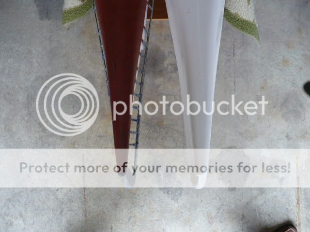

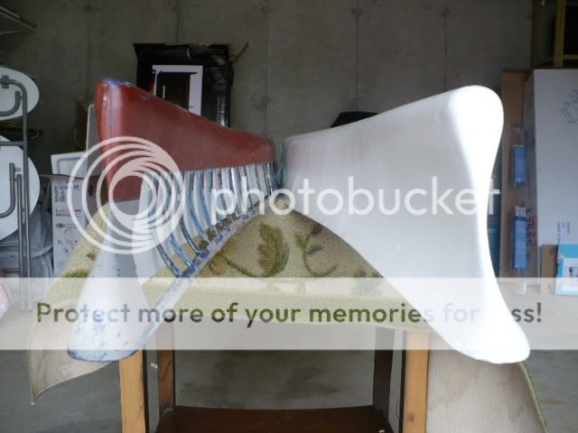

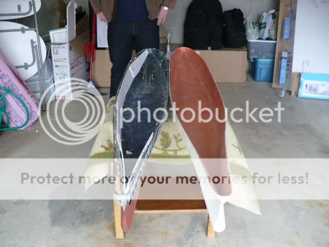

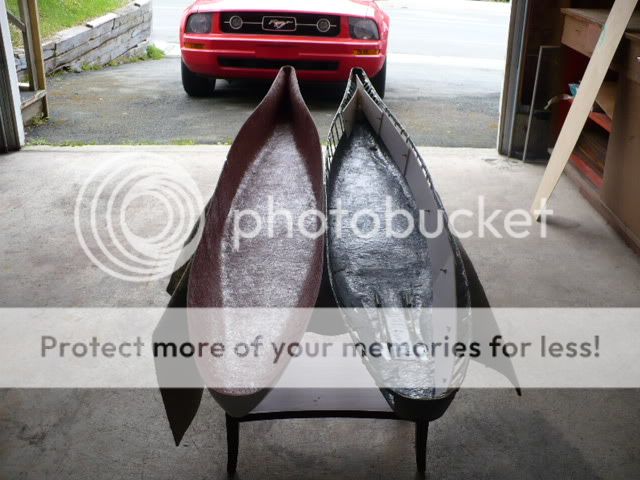

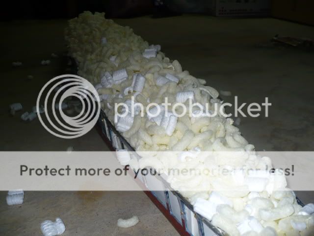

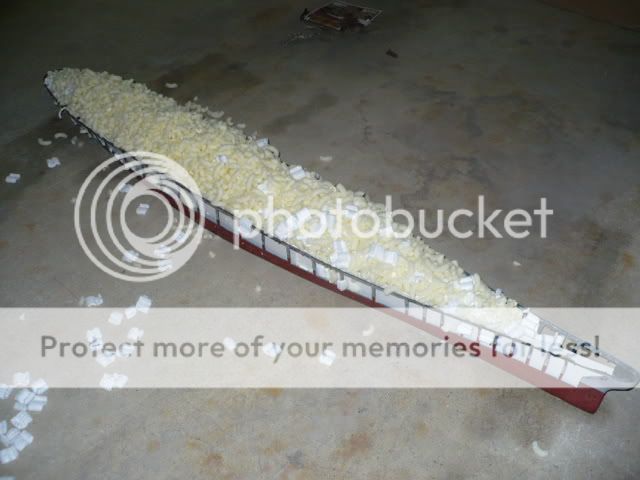

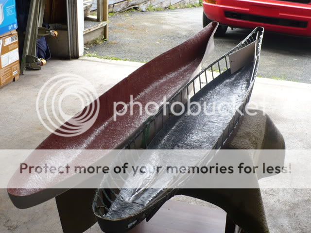

    We unpacked the IOWA from it's carboard coffin today and it was quite packed with peanut popcorn. We took my hull and Tom's and took side by side comparison's of both ships. I still have other pics to load but this is what we got so far. ...

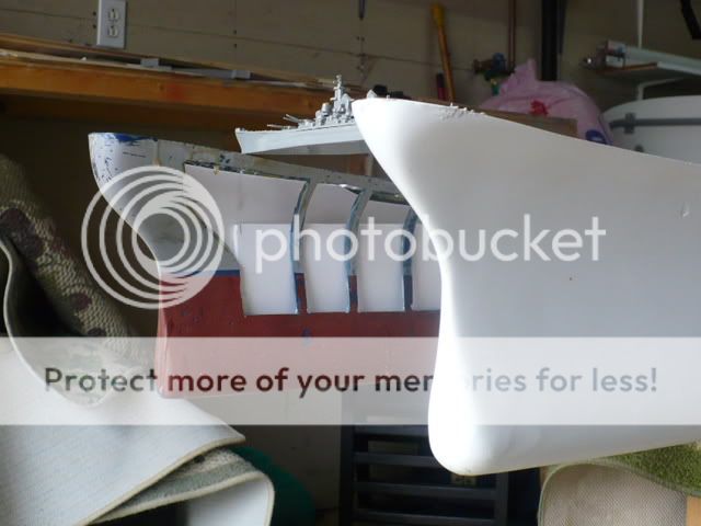

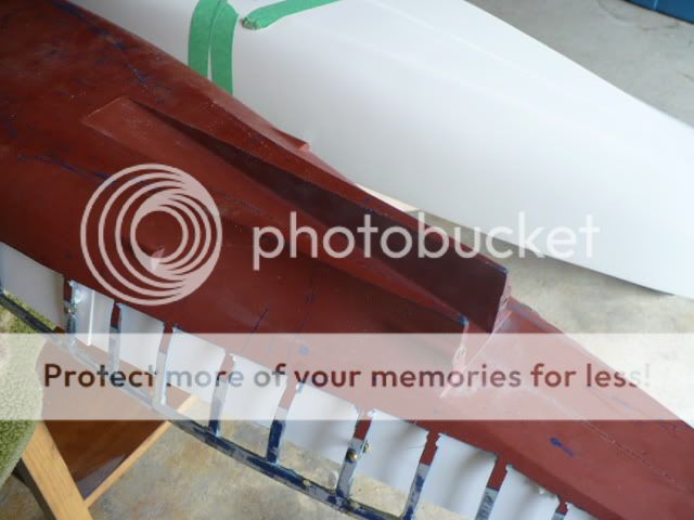

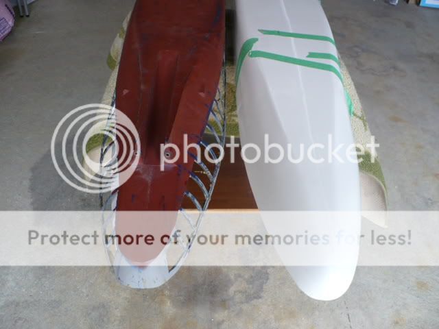

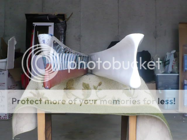

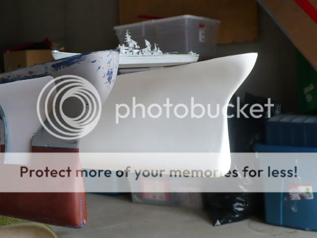

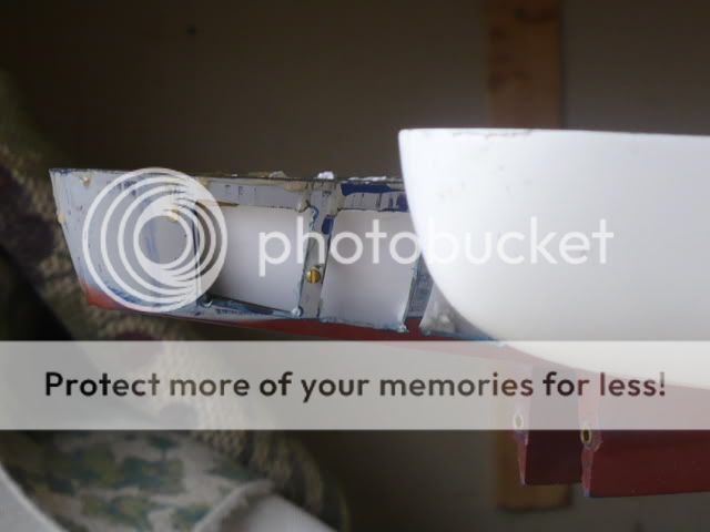

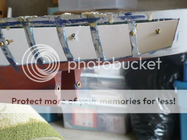

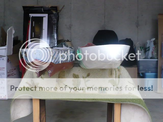

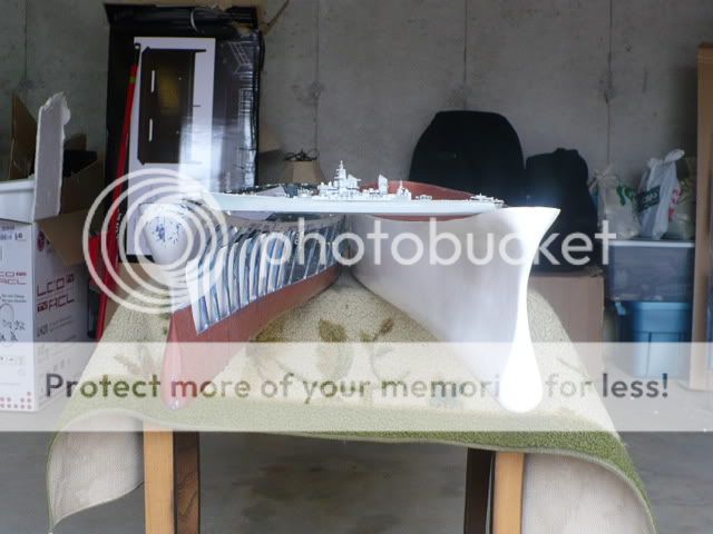

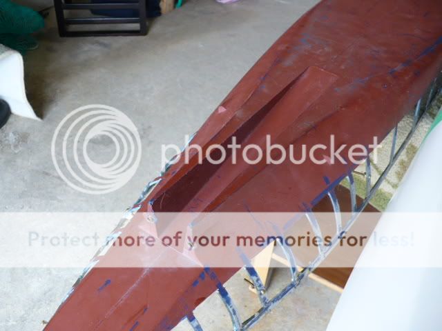

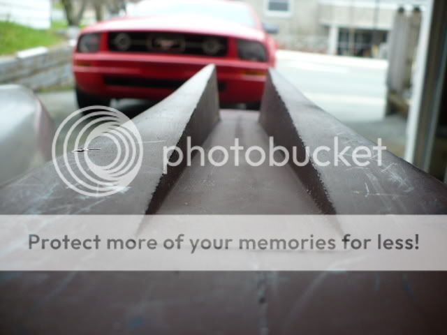

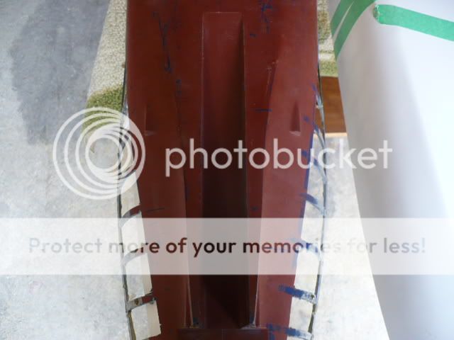

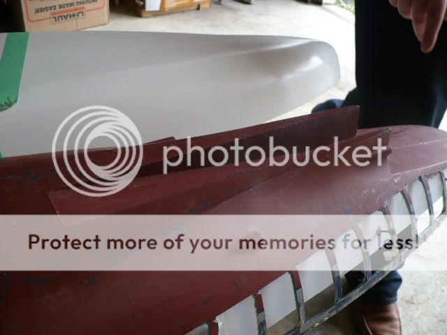

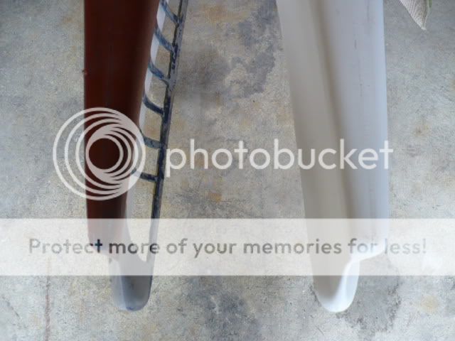

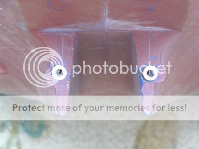

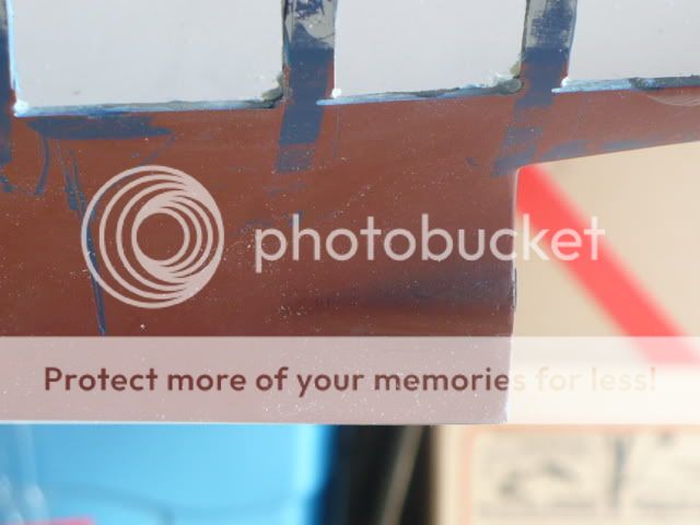

    More pics of side by side comparison of Ralph's IOWA class hull and Strike's....
  15. bb26
    Interesting to see a Ralph hull and a strikemodel hull side by side.
  16. djranier
    They both look like they are too big, and will be a real chore to handle.
    Surprisingly they both fit in Tom's Mustang with room to spare. They are not as heavy or as bulky as Yamato. Bismarck feels like nothing to me after lugging Yamato around. The Iowa is not much longer but narrower than Bismarck and only a few pounds heavier. I bruised my ribs carrying Yamato on more than one occasion. The big ships require more effort to load up and carry but proper lifting techniques and taking care rounding corners and loading in the car is required. I use to carry Yamato and Bis in my small Hyundai Excel Hatchback and currently use a 4 door Hyundai Accent compact to transport the ships. I had Roma, Yamato, Warspite and Prinz Eugen(VU) loaded up in that car on an angle. Got them in along with the tool box and 8ft table and portable barbecue.

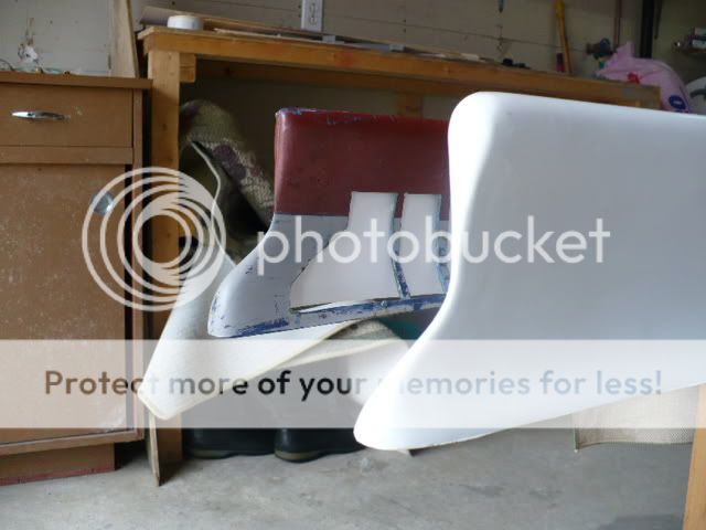

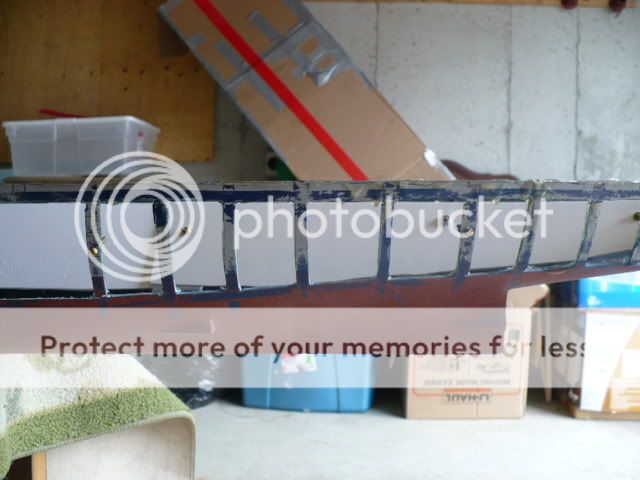

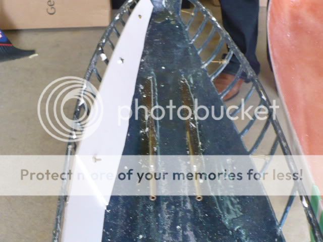

  18. jadfer
    Well that is some really good detail shots of the inside of the Strike Models hull, I have been wanting to see that. It looks good, however it is (obviously) missing the skegs. Is that a big deal to most people? My first thought is I would want them on it.
  19. CURT
    I was hoping they would come with the skegs too but some people prefer not to have them on as they may want to make their own.
