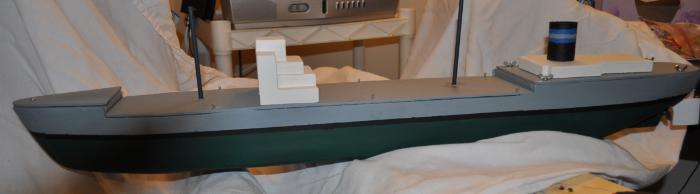

  7. Kotori87
    3,561
    Very spiffy, Nick. I like it.

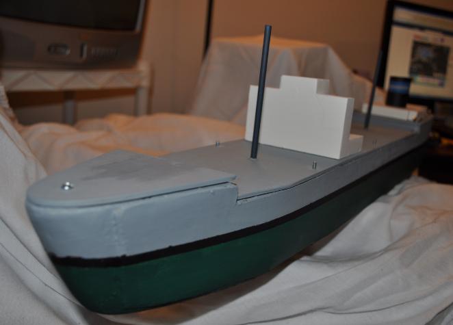

  15. NickMyers
    The bow decking isnt actually held down, it just has loose guide rails and about 8-10 feet of line bound to the first rib. In theory when she goes down, it'll float free and the line will pay out. In theory.
    I think I need an underwater camera.
  16. NickMyers
    To close this out, she's been out to two combat events and has handled quite well. She's a frustrating target and while she's gone down once she looked good doing it.

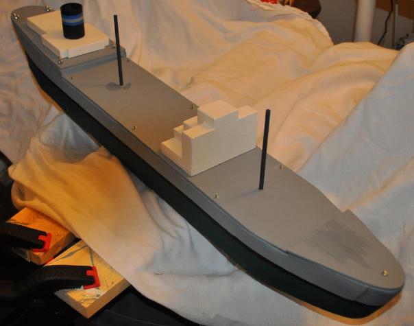

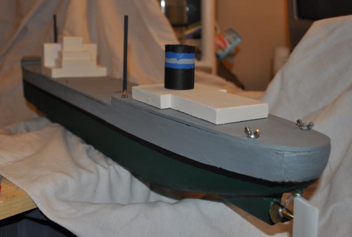

  18. Gascan
    Looking good. I think you need to update your signature.
  19. NickMyers
    Thanks guys
    @Gascan, I'd update it if I could :(
    @Kotori, Uhm, Well, it was a really windy day, and early on a ridiculous gust of wind actually managed to knock it out and the prop fouled on it, so I added a 1/2oz of weight held on by a magnet, and of course, being in a hurry, forgot to see if the float could actually bear that weight and still float - the answer is no as we discovered, which made its recovery more difficult than it should have, completely my own fault too. Some experimentation will have to occur here to find out how to both make it more bouyant and keep it held down a little better against rogue winds.
  20. Hovey
    Hovey Admiral (Supporter)
    323
    Washington
    Other than the deck/float issues she has proven a great ship to play with. She is low in the water and turns well enough that with a an experienced captain she is a very hard target to hit.
    I would just screw down the deck and add a float inside the funnel. Of course that would require replacing the funnel I knocked off while trying to recover her. As long as you add flood holes at the bottom of the funnel they work pretty well that way.
