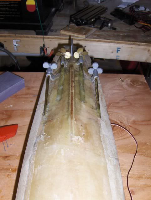

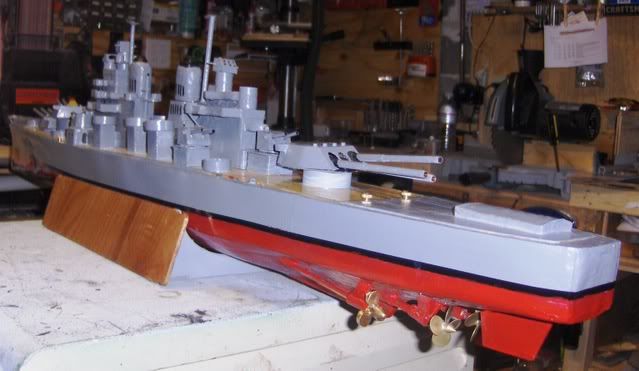

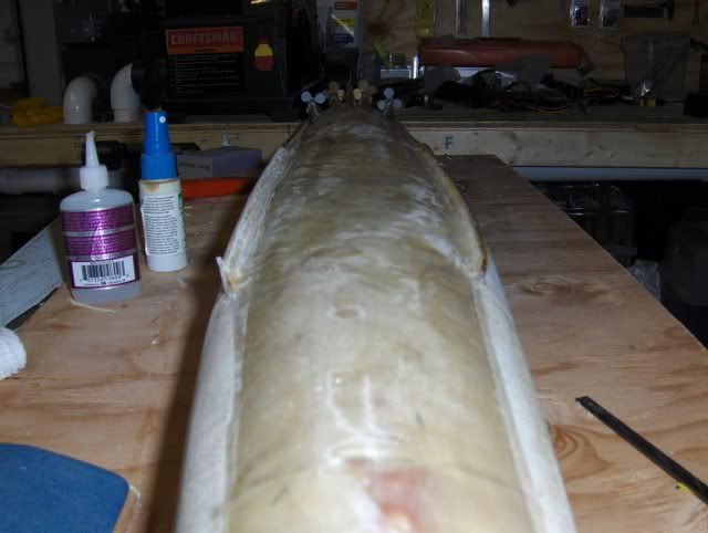

  5. djranier
    Swap the propellers, the way they are installed you will be throwing alot of water out to the sides when going forward. We just tried the same thing in my Kumano, and BC Ricks new Scheer, and it did not work very well with the props turning outwards at the top.
  6. Powder Monkey
    How do you figure wouldn’t it throw more from out sidebeing out side my props turn in I think humm now I have to go look?[:(]
  7. Powder Monkey
    nope mine turning out at top two well should be in the water tusday will know for sure than
  8. djranier
    I thought the same, that it would be best out at the top, but for our cruisers it was not, they were slow, and did not turn so well. I spotted it on one of your pictures.
  9. Powder Monkey
    so what did you do to fix it ?
  10. Powder Monkey
  11. djranier
    Just reversed the props, so the top turns in, and not out.
  12. Powder Monkey
    Okay thanks I will research this a little before I go ripping it apart thanks for the heads up

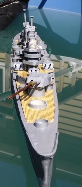

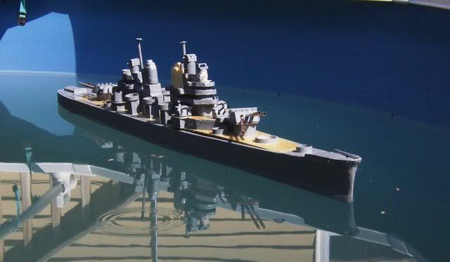

  14. Powder Monkey

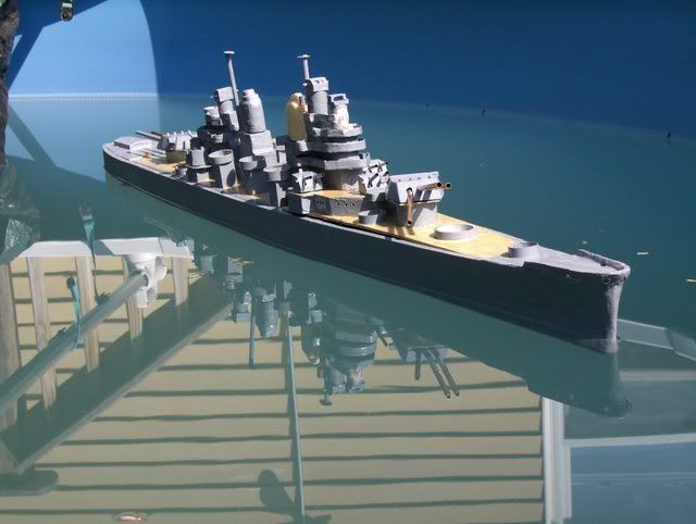

    Launched
    It floats she is listing a little but that is do to equipment just thrown in for battle weight not secured yet. and best of all no leaks . I rocked it a little she wiggles & wobbles but doesn’t fall down [;)] I pushed it to around 20* starboard and let it go recovered in 3 trips back to starboard not to shabby [^]

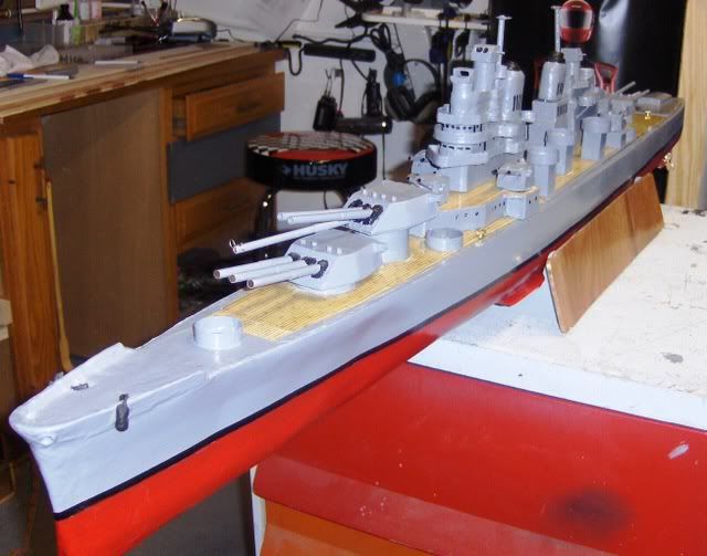

  15. Powder Monkey
    [​IMG]'/>
    <img src='<img alt="" src="http://i194.photobucket.com/albums/z12/powdermonkey8/USS%20Boston/Picture407.jpg" />
  16. djranier
    With all her paint on she looks very nice, great job. So what ship next? Scharny?

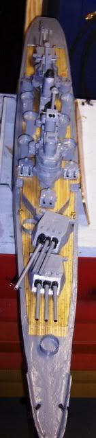

  20. Powder Monkey
    A Few More
