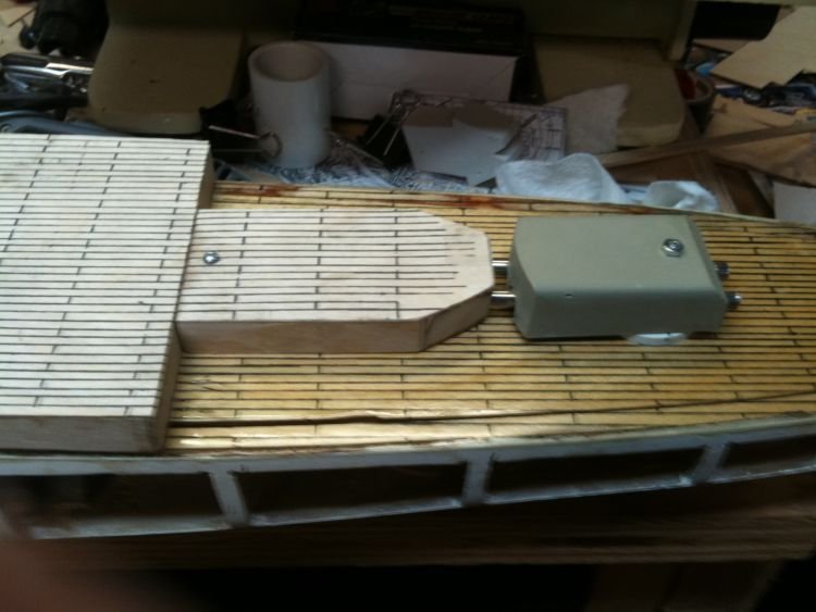

    Box still mostly done like last time just pondering if I should add an additional switch on top of the ESC switch for power. Need to finalize the test buttons for my duals. Guns are mounted and I must say I kept my pa's old KISS concept w/ some growth and it looks like it could work. That means to do that half of my superstructure is done because I hide the guns in the rear portion of the superstucture w/ the tips of the barrels poking out of the turret. I made my own stucture even though I bought a houston structure from Stephen and Keri figured may as well give it a go. I will use their foam for my upper stucture of the Indy the lower portion is 1/16 3 ply sides w/ 1/32 3 ply for for superstructer decks.

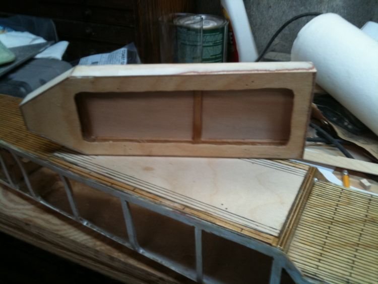

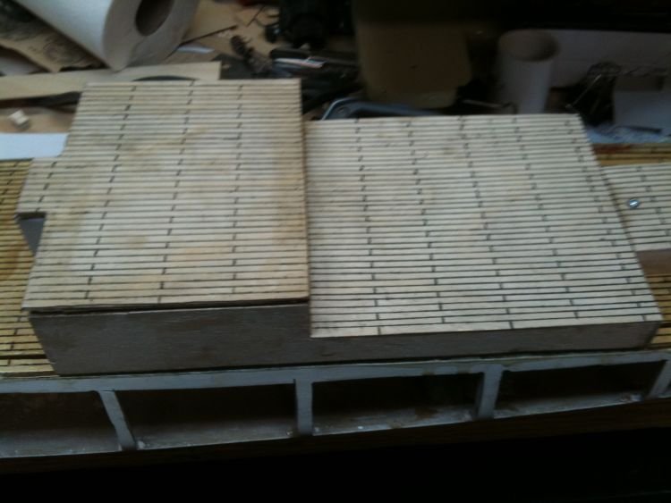

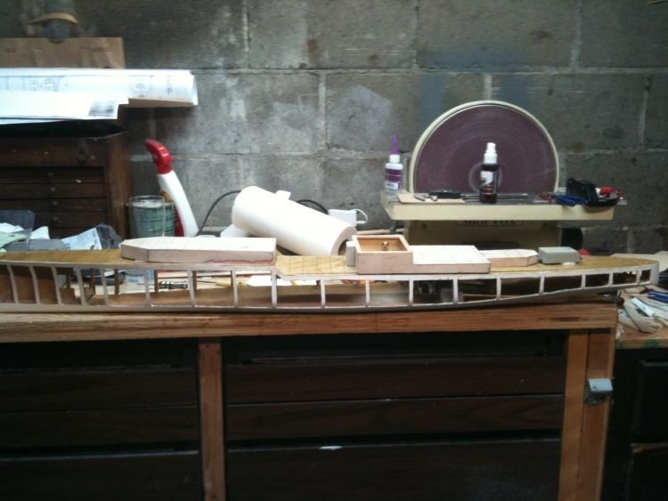

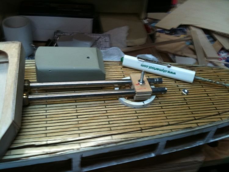

    What is that interwebz meme pics or it didn't happen? So here is some..

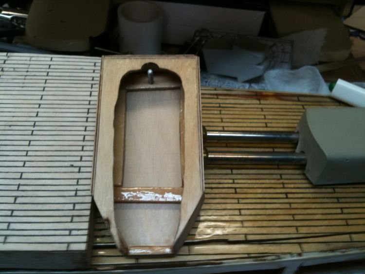

    only missing from the rear director tower is showing my breeches under it did this on the fly w/ my iphone..

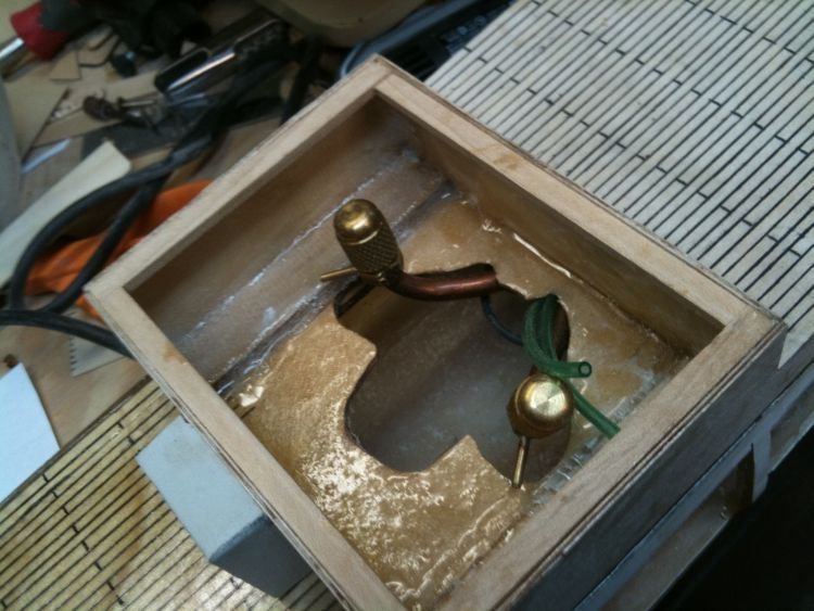

    Now the underside of the forward superstructure minus bridge and the barrel mount on the rear deck. I have one shim in it that I can take it out currently the barrels are pretty much parallel w/ the deck. I am hoping w/ shims I can change the angle of aim if I hope to later on.[​IMG]
