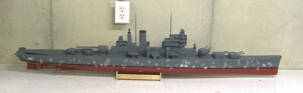

    The Roanoke completed 14 sorties this weekend at the Treaty conference event, with no sinks! Overall things when well, I gave as good as I got for the most part. I had one sortie with intermittent radio drop out - it's very frustrating when you cannot move away when someone is shooting you full of holes. I took myself out of the last sortie of the weekend by bumping my rudder and stripping the servo gears when I took the boat out of the water. Other than those minor problems, the whole match went well.

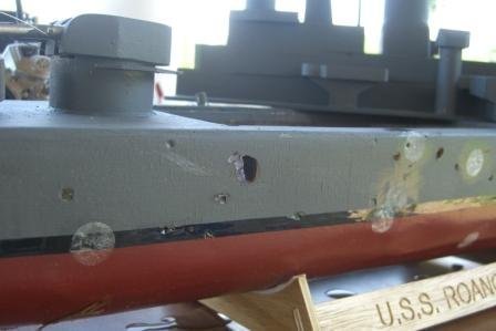

    I need to change a couple of things of course. I need to get a lighter superstructure. At 10 ounces, it's a little too much on top. Plus I learned that the most robust pieces still get shot off. My top director is still visible in the picture above, but only because it drifted to the side of the pond and I was able to retrieve it and glue it back on. I also had guns shot off, radar dishes shot off, and I lost a lot of armor shield around the secondary guns. On a positive note, the turrets took several hits but were undamaged. I also learned that you need the internal bb shield even between the first two ribs. I left it out because there was no easy way to put it in, which resulted in several blow throughs. Ouch. Fortunately I was fast enough and kept enough distance that the hits on or below the water line were limited and the pump could keep up with all the damage. Overall, a very satisfying first battle!

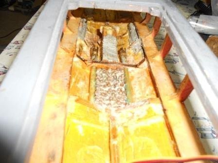

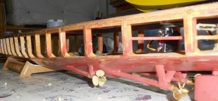

    After two years of battling, it was time to haul the Roanoke into dry dock and perform a retrofit. The side were mostly paper and a significant amount superstructure detail was missing. I started by pulling out all of the components and doing a thorough functional check. There was a lot of rust on the motors, but with a little oil on the bearings I consider them good to go. As I removed the BB shields, I ran into the first problem. I used some #2 screws to hold the shield to the ribs, which made a very tidy installation. When I went to unscrew them, they were rusted to the ribs and the head was so small that I could not get enough grip on them to unscrew them. When I put the shield back in, I'll use bigger screws and make sure they are stainless steel.
    Next I took off the balsa sides. Using Harbor Freight oscillating multi-functional tool with a scraper blade, the sides just peeled right off. The ribs underneath the sides were in very good condition. I used spar varnish to seal the wood and it worked very well, I noticed no areas of water damage on the sides.

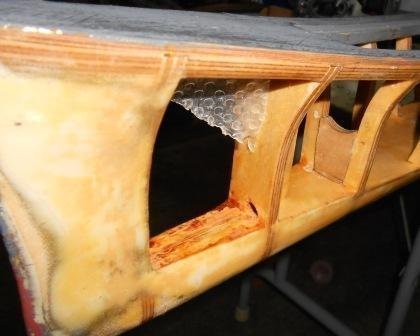

    The first surprise was when took the sides off the first rib bay. Because the second rib is very narrow, I just had a small hole to let water out, but the hole was not big enough to let out BBs. I recovered around 30 BBs just from the one bay and you can see a little of the rust left in the bottom of the bay. I'll have a big enough hole to clear BBs when I finish the refit.

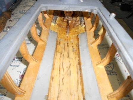

    The bottom of the ship was sheeted with 1/8" balsa. On the outside, I fiberglassed it with 3 oz cloth and it held up very well. The inside of the balsa also formed the bottom of the water channel. On the inside I just coated the balsa with epoxy. The epoxy cracked in several places and let water into the balsa, as can be seen by the dark lines in the bottom of the water channel. So in the future I'll coat the water channel with self-leveling polyurethane, which is flexible enough to keep the wood sealed.

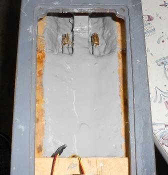

    I removed all of the self-leveling polyurethane that I had originally put in. Around the motors I had put the polyurethane too thick and had to dig some out just to get the motors in. This resulted in some dips where water could collect and I wanted to get rid of these and smooth out the area. Where needed, I used some two-part foam to smooth out the bottom, and then coated the bottom with a coat of polyurethane. One of the great properties of the self-leveling polyurethane is that if you paint on a thin (relatively speaking) coat, it will stick to the walls and act like a very thick paint. The self-leveling property means that the surface is smooth, without drips or runs, and you get a very durable coating about 1/16" thick. Here's some before and after pictures.

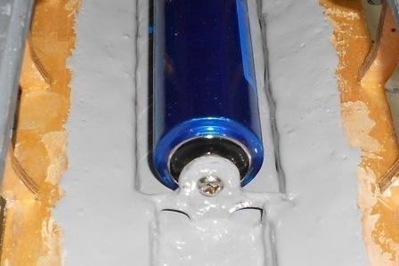

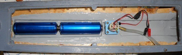

    Part of the refit will be to recycle the 4.5 Ahr SLA battery and replace it with a LiFe battery. The SLA worked OK, but its center of gravity was fairly high and it was prone to shifting. This contributed to rolling over a couple of times and sinking when there was not enough water on board to otherwise cause a sink. The new Headway 10 Ahr cells fit very nicely in the water channel. The batteries are lighter, have more capacity, and sit lower in the ship. I'm looking forward to testing these batteries on the water.
    The batteries are bolted through a 1/8" fiberglass plate on each end - there will be no shifting of these batteries.:)

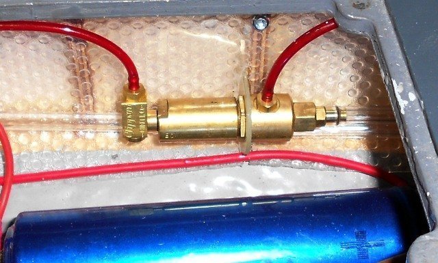

    I was surprised by the amount of scale I found inside the actuators. Since I wasn't careful about the valve orientation when I installed them, the vent hole on the actuator was not on the bottom where all the water could drain out. So each time water got in the actuator, it had to evaporate, leaving all the scale behind.
    For the re-fit I made valve mounts from 1/16" fiberglass. The valve is held to the mount with a nut and the actuator is set so that the vent hole is at the bottom. Loctite ensures that the actuator will not unscrew. I also put the valves in the main bay instead of under the deck, so maintenance will be easier.
    On the front gun the valve (shown) there has about 14" of hose between it and the pilot solenoid. The valve wasn't closing fast enough for me, so I added a quick exhaust valve to the actuator. Now it closes very quick!
